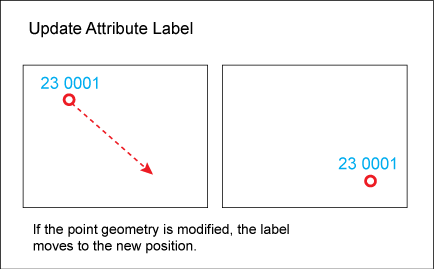

The UpdateAttributeLabel rule group updates label features when a geometry feature is updated. The rule group applies to Utility geometry feature classes.

Updates the label attached to an attribute when the geometry is updated.
