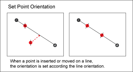

SetPointOrientation rule group
The SetPointOrientation rule group specifies that when a point is inserted or moved onto a line, the orientation of the point matches the line orientation.
