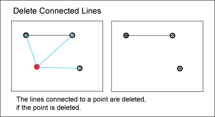

The DeleteConnectedLines rule group deletes lines connected to a point when the point is deleted.
- DeleteConnectedLines_BD
- DeleteConnectedLines_AD
The rule group applies to Utility point feature classes.
