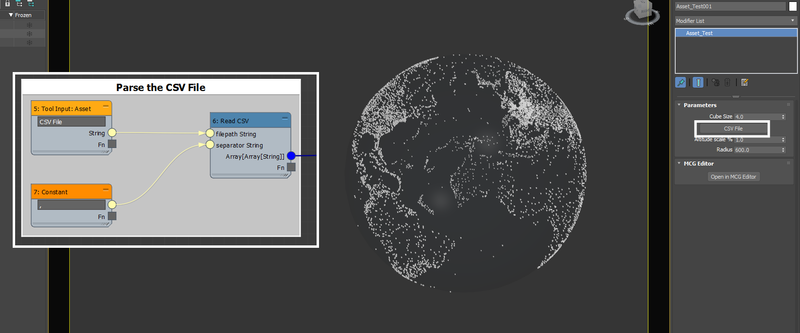

The Tool Input: Asset generates a button which opens a file browser dialog. This dialog can be used to pick a valid file on disk. When used in conjunction with the Read CSV, Read Lines, or Read Text operators, this input can be used to access additional data on disk.
In the screenshot above, comma-separated values (CSV) are read from a picked file, and converted into position offsets for a cube mesh.
