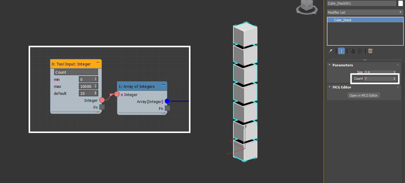

Tool Input: Integer
The Tool Input: Integer generates a labeled integer spinner in the rollout. This is useful for specifying whole, non-decimal numbers in the graph. Consider connecting an integer input into an Array of Integers or Array of Floats Inclusive to begin your graphs.
