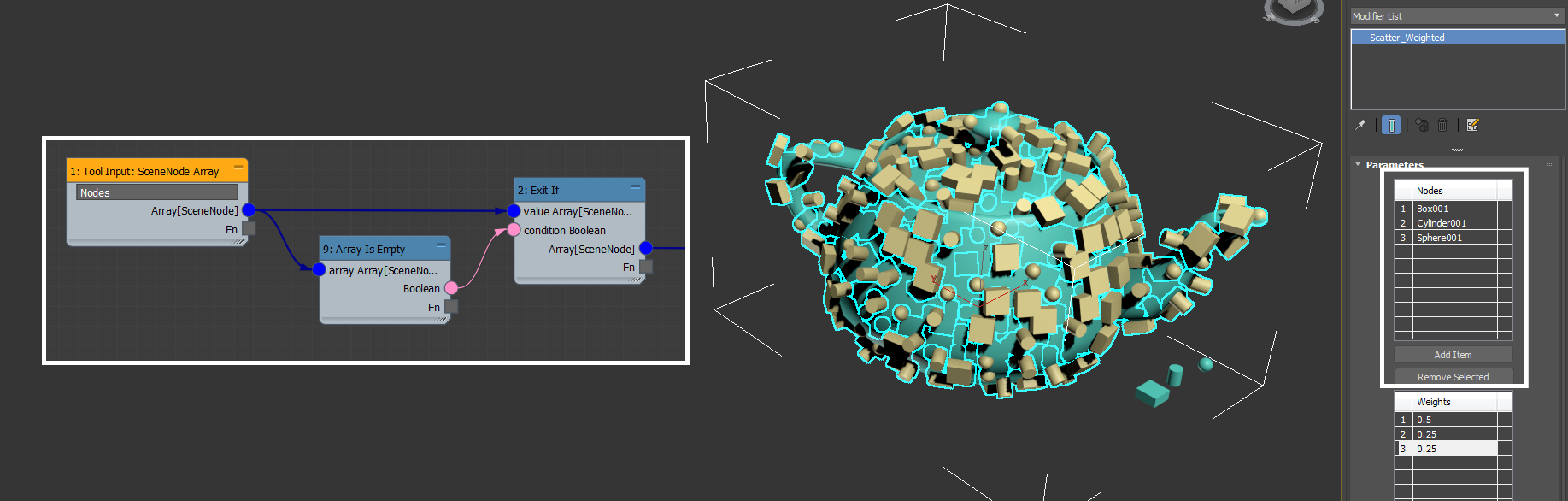

Tool Input: SceneNode Array
The Tool Input: SceneNode Array generates an array which can be populated by picking nodes in the scene. This input is useful if you want to specify an "inventory" of nodes to choose from.
Press the Add Item button to begin picking the nodes you wish to add. Right-click to end the picking session.
You can remove items from this list by selecting an item and pressing Remove Selected.
