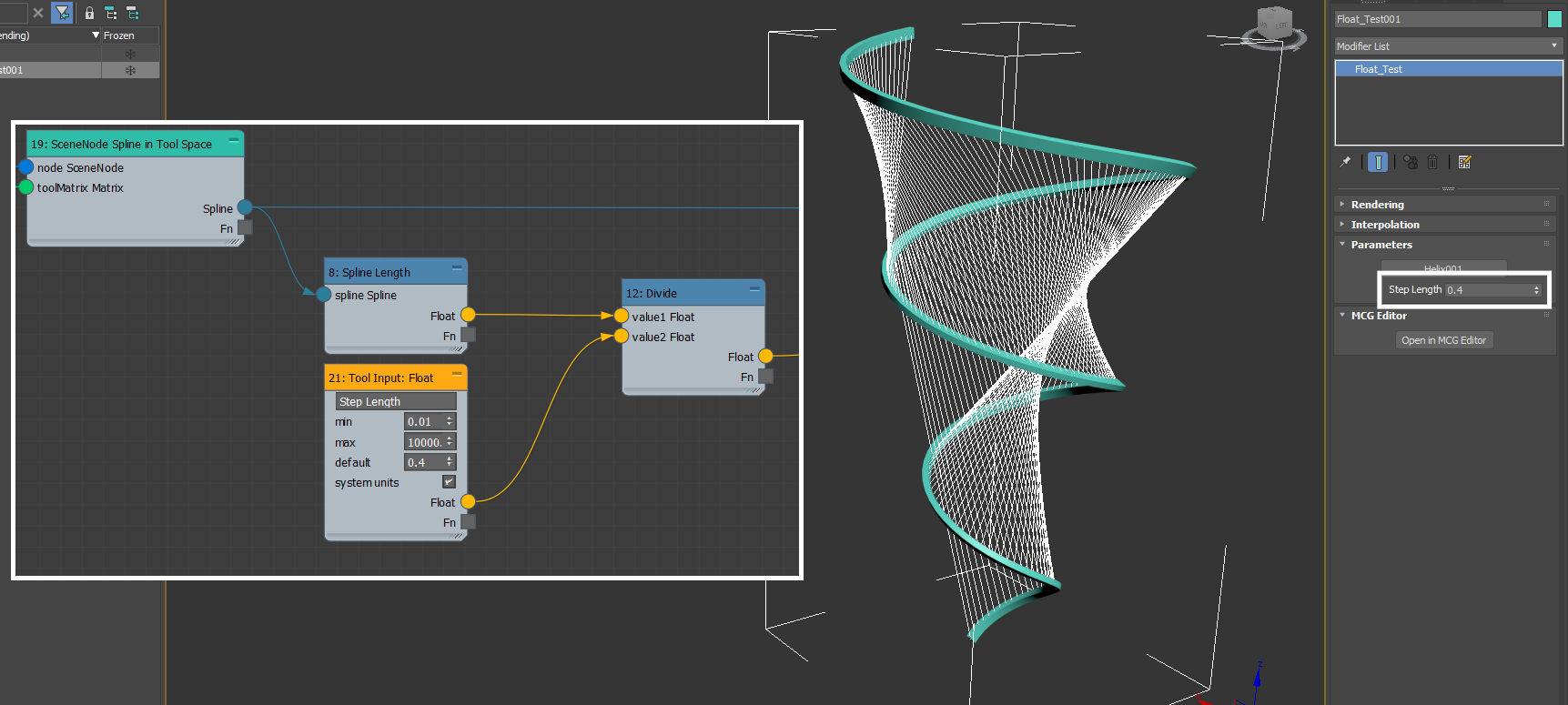

Tool Input: Float
The Tool Input: Float generates a labeled spinner in the rollout. Enabling the System Units will display the value in the spinner based on the currently active system units. If the float represents a proportional value (for example, between 0.0 and 1.0), we recommend leaving System Units disabled.
