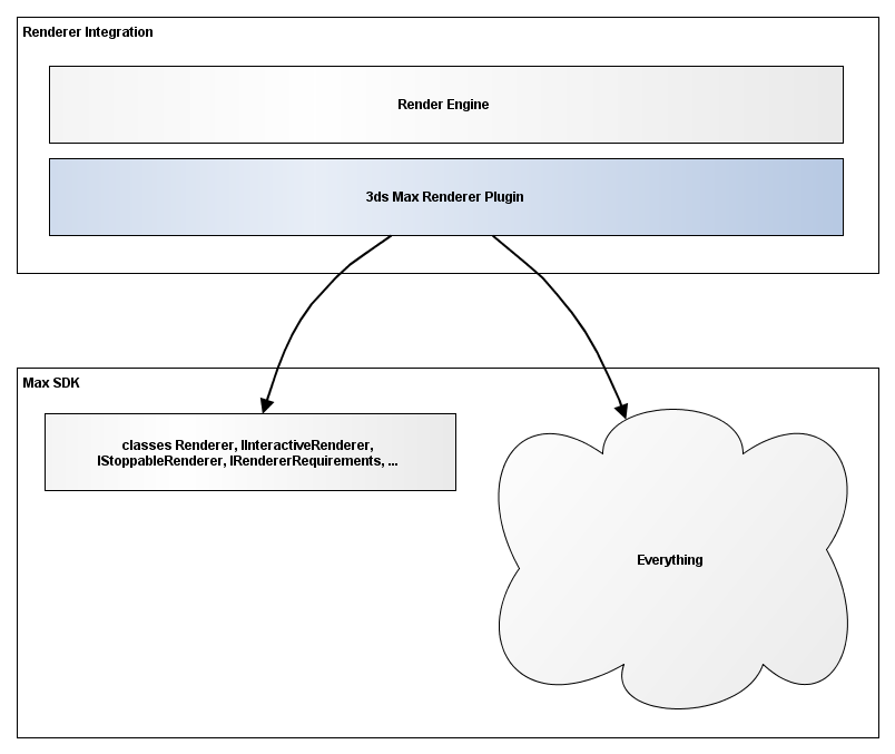

The legacy rendering API is dominated by two classes: Renderer for offline rendering, and IInteractiveRenderer for interactive rendering; with several other (extension) classes which may be grafted onto these two. Class Renderer enforces a monolithic design to the renderer plugin. The same class is responsible for: UI, file I/O, scene translation, and process management.
Legacy API Concept
The Rendering API introduces a more stringent framework by splitting the design into multiple components. This provides a more coherent structure to the renderer plugin and enables a significant part of the logic to be moved to the 3ds Max core.
