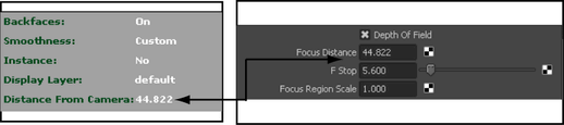

To ensure the center of an object is in focus for Depth of Field
- Select the object in the view.
- Make sure Object Details is turned on in the Heads Up Display menu. (Object Details is on by default). Notice the Distance from Camera value.
- Enter this
Distance from Camera value as the
Focus Distance in the
Depth of Field section for the current camera's
Attribute Editor.
If you select multiple objects, Maya uses the center of their bounding box to calculate the distance from the camera.
In this example, the apple in the center of the bowl is selected to be in focus. The Heads Up Display indicates that its distance from the camera is 4.46. Depth of Field is then enabled, and this value entered as the Focus Distance.

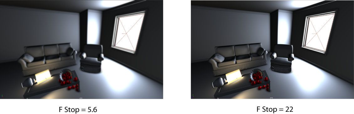

To increase or decrease the amount of depth of field
Adjust the Depth of Field > F Stop value to increase or decrease the amount of depth of field. Use a higher fStop value (for example, f-16, f-22, f-32) for a deeper depth of the field where more of the foreground and background is in focus. Use a smaller fStop value (for example, f-2.8, f-4 or f-5.6) for a shallower depth of field, where more of the foreground and background is out of focus and blurred.
The size of the aperture is measured in fStops. The fStop is the focal length divided by the diameter of the aperture. Therefore, the smaller the aperture, the greater the fStop number. See fStop (aperture) and shutter speed/angle.
