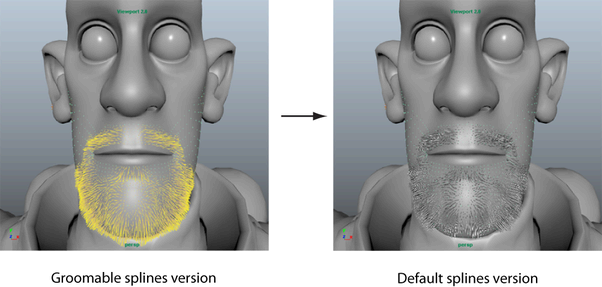

In this part of the example, you preview the default spline version of your groom. You can switch back to the grooming brushes at anytime and continue grooming with them.

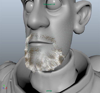

  2. To preview your groom as default splines, click the Preview icon .
    The default splines display in the areas you populated with groomable splines.

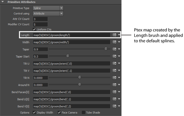

  3. Click the Primitives tab.
    Notice that for many attributes, a map file path displays instead of numeric values. This indicates that the attributes are controlled by Ptex maps. These maps are created and updated when you paint with the Grooming brushes.
    You may need to further edit the splines to generate the desired look for the character's beard. For example, you can add taper or color to the splines.
  4. To add taper to the splines, in the Primitive Attributes section, set the following:
    • Taper: 0.2
    • Taper Start: 0.3
