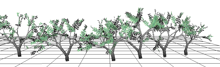

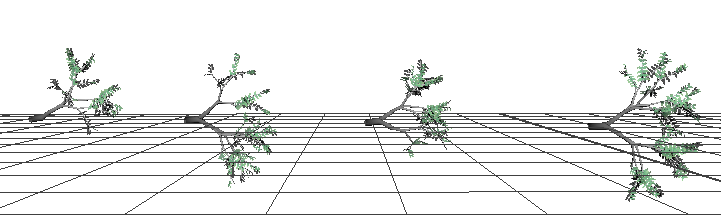

Use Flip Tube Direction to switch the direction of the current brush between Along Path (often best for canvas painting of plants) and Along Normal (often best for scene painting of plants). The difference between the two tube directions varies according to brush type and settings, so experimentation is worthwhile.
Simple Tree Brush Painting Along Path in a Scene
Simple Tree Brush Painting Along Normal in a Scene
