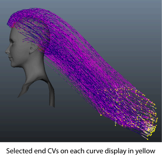

- Select the curves to which you want to apply nConstraints.
- Select
nHair > Convert Selection > To Start Curve End CV's.
The end CVs of the selected curves are selected.
