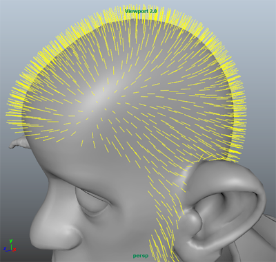

- Click
Generate to create the (.xuv ) file point map.
The map is stored in the Description's Points Dir.
Yellow lines identify the point positions of the map.
In the Maps section of the Generate Clumping Maps window, you set up the control map XGen uses to generate clumping guides on surface. If your Description uses a Region Map, Use Control Maps is on automatically. This ensures that clumps cannot cross the boundaries defined by the Region Map.
In this example, a Region Map is used so the Use Control Maps is on.
- Click
Save.

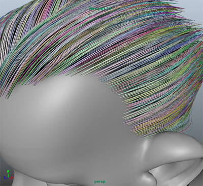

The clumping map modifies the hair style. You can see how the map affects the splines by turning on the Color Preview.
- Under
Modifiers and beside
Options, turn on
Color Preview.
Splines belonging to each clump (and clumping guide) now display in the same color. You can also view the clumping guides only.
