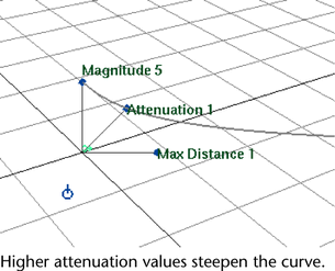

Attenuation
Attenuation is represented by a curve that shows how quickly the field’s strength falls off from the field’s position to the end of Max Distance. If Max Distance is infinite, the curve is drawn 100 units long.

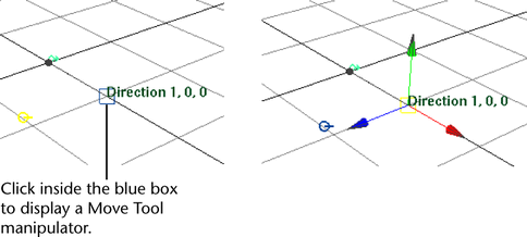

Direction X, Y, Z or Axis X, Y, Z
Click inside the blue box to display a manipulator that’s the same as the Move tool. Drag the center to move in all directions, or drag one of the arrows to move with directional constraint.

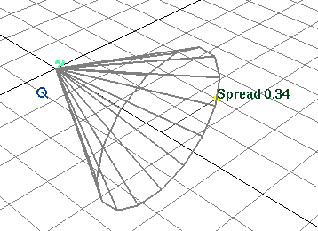

Air field's Spread
Drag the dot icon in various directions until you see a cone that indicates the Spread angle. When you begin to drag the dot, a line appears in the workspace indicating the direction you can drag.
