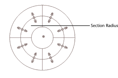

Section Radius
Defines the thickness of the solid portion of a torus volume shape.

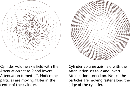

Invert Attenuation
When you turn on Invert Attenuation and you have Attenuation set to a value greater than 0, the strength of the volume axis field is strongest at the edge of the volume and diminishes to 0 at the central axis of the volume axis field (see also Attenuation.
