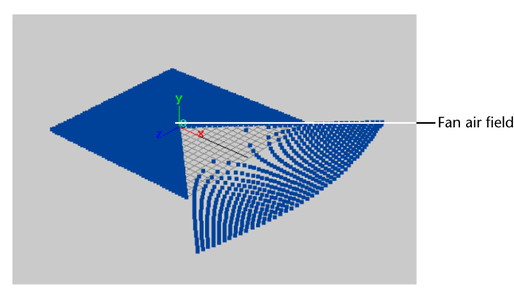

Fan
Sets the Air Field attributes to default settings that approximate a local fan effect. The connected objects move in a 45 degree spread along the X-axis at 5 units per frame.
By default, the fan air field creates an air pattern similar to this:

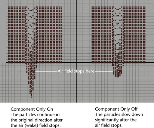

Component Only
If Component Only is off, the air field applies whatever force is necessary to make the affected object's velocity match the air field's velocity.
If Component Only is on, the air field applies force only in the direction specified by the combination of its Direction, Speed, and Inherit Velocity attributes. Also, no force is applied to slow an object along that direction; force is applied only to increase the speed.
Only objects moving slower than the air field are affected. Objects moving faster than the air field continue at that speed.
Component Only is turned on when you turn on the Wake button. The option has effect only when Inherit Velocity has a nonzero value.

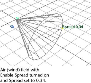

Spread
Enable Spread
Specifies whether to use the Spread angle. If Enable Spread is turned on, only connected objects within the area specified by the Spread setting are affected by the air field. The motion is spread radially outward in a cone-like shape. If Enable Spread is off, all connected objects within the Max Distance setting are affected by the air field. The motion is uniform in direction.
If you set the Magnitude attribute to a negative value when Enable Spread is turned on, the particles are attracted toward the field center. You can use this to create an effect where the particles get “sucked in.”
Spread
Represents the angle from the Direction settings within which objects are affected by the air field. When Enable Spread is on, the air field pushes from its point of origin in a cone-like shape.
With a value of 1, any object in front of the air field are blown 180 degrees along the direction vector. With a value of 0, only objects exactly in front of the air field are blown along the direction vector. Values between 0 and 1 blow objects in cone-like shape along the direction vector.
