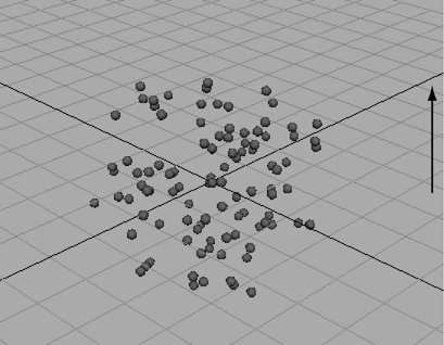

Suppose you’ve used the Particle Tool to place a collection of particles in the workspace. You then create the following creation expression to control their velocity:
particleShape1.velocity = <<0,1,0>>;
All the particles move in a Y-axis direction at one grid unit per second as the animation plays.
