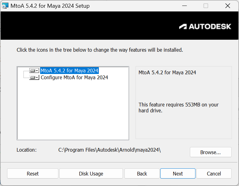

  3. Keep the default installation options, and click through the Setup Wizard until the setup is completed.
  1. Choose which features of MtoA you wish to install and where you want to install it.

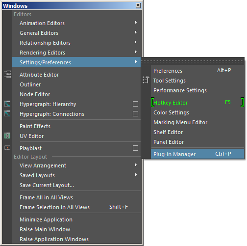

  3. Start Maya and click Window > Settings/Preferences > Plug-in Manager.

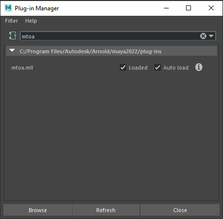

  1. In the Plug-in Manager, click the Loaded and Auto Load checkboxes for mtoa.mll, and then close the Plug-in Manager.
You should now be able to render with Arnold.

To do this, when you run the MtoA installer, clear the Configure MtoA for Maya check box. The following instructions assume that you are using Windows, Maya 2023, and that you copied MtoA to the network folder \server\arnold\mtoa\2023.
Next, complete the following steps:
  1. When you extract MtoA to a temporary location, clear the Configure MtoA for Maya check box.
