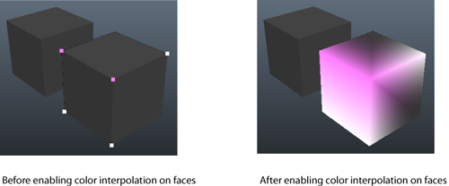

When visualizing metadata, if you select color as your visualization method, you can also extrapolate the color to the faces surrounding the vertices/vertex faces. This functionality helps you to better understand how your data is distributed across the surface.
To enable this option, select
Display > Polygons > Metadata > Visualize Metadata >
to open the
Metadata Visualization Options window and select
Enable color interpolation on faces.
Color interpolation on faces
