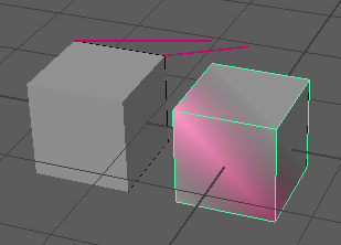

The example provided below demonstrates how to attach two streams of metadata (StreamOne and StreamTwo) to the vertices on two objects (smcPlane and smcPlane1), and how to visualize the data streams one by one in Viewport 2.0. It concludes by disabling the visualization.

// NOTE: By default, all streams are hidden.
// Activate visualization of "StreamOne" for one cube. Use color mode.
showMetadata -stream "StreamOne" -member "Color" -dataType "float[3]" -method "color" smcPlane1Shape;
// Metadata is now visible.
// Auto remap the data range of the values in the stream.
showMetadata -stream "StreamOne" -member "Color" -dataType "float[3]" -method "color" -auto smcPlane1Shape;
// Enable color interpolation to extrapolate color to the faces surrounding the vertices
showMetadata -stream "StreamOne" -member "Color" -dataType "float[3]" -method "color" -interpolation true smcPlane1Shape;
// Activate visualization of "StreamOne" for the other cube. Use string mode.
showMetadata -stream "StreamOne" -member "Color" -dataType "float[3]" -method "string" smcPlaneShape;
// Metadata is now visible on both cubes.
// Now, activate visualization of "StreamTwo" for the second cube. Use ray mode.
showMetadata -stream "StreamTwo" -member "Color" -dataType "float[3]" -method "ray" smcPlaneShape;
// The rays appear too long.
// Scale the length using the rayscale flag.
showMetadata -stream "StreamTwo" -member "Color" -dataType "float[3]" -method "ray" -rayScale 0.3 smcPlaneShape;
// The visible metadata has now changed, and you have now used all three methods of display.
// Deactivate the stream.  To turn off visualization on an object, specify the stream name and use the off flag.
showMetadata -stream "StreamTwo" -member "Color" -dataType "float[3]" -off smcPlaneShape;
// Now metadata is no longer visible on the second cube (smcPlaneShape)
In this example, StreamTwo is visualized on smcPlaneShape in ray mode with the Ray length scale set to 0.3, while StreamOne is visualized on smcPlane1Shape in color mode, with the data range automatically remapped and color interpolation enabled.
