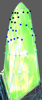

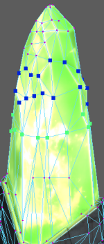

For example, if you have two data assignments, one with values (0.25, 0.5, 1.75) and one with values (0.8, 2.0, 1.1), as shown below, then the minimum is set to (0.25, 0.25, 0.25) and the maximum is set to (2.0, 2.0, 2.0).
The minimum value is interpreted as black and the maximum is interpreted as white. In other words, if you now add metadata values of (0.25, 0.25, 0.25) and (2.0, 2.0, 2.0) to the stream above, these are displayed as black and white, respectively.
All other values are interpreted relative to the new minimum. For example, the vector (0.25, 0.5, 1.75) is now interpreted relative to a 0.25 to 2.0 scale, and not relative to a 0 to 1 scale. The R and G values are at the low end of the 0.25-2 scale while the B value is at the high end of the 0.25-2 scale. Therefore, the vertices are displayed mainly as blue.
Likewise, when interpreted on a 0.25-2 scale, the vector (0.8, 2.0, 1.1) has a dominant G value. The vertices are therefore displayed mainly as green.
