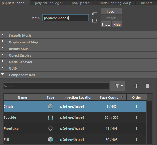

- To view the Component Tags Attribute Editor widget, select geometry, and click its shape node tab (for example pCube1,) in the Attribute Editor, and expand the Component Tags area.
Component Tags table in the Attribute Editor
Use this table to edit Component Tags membership from the shape node in Attribute Editor. To add Component Tags to an object, see Assign Component Tags to geometry.

Add
Click to add an entry to the Component Tags table. If components are selected, they are included in the new tag. See Assign Component Tags to geometry. |
Remove
Deletes the currently selected Component Tag from the scene. |

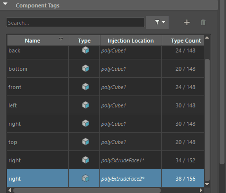

| Name | The name of the corresponding
Component Tag.
Names with an * (asterisk) beside it indicates that a Component Tag coming from upstream has been modified. |
| Type | Icons in this column correspond to the
Component Tag type:
| Injection Location | The original position of the deformer. |
| TypeCount | The number of components included in the
Component Tag/ The total number of components, in the
Component Tag category.
For example, a cube with one face as a Component Tag would show in this field as 1/6. |
| Order | The sequence of the Component Tag position in the deformation chain of the injection node, with the lowest number indicating the furthest upstream. |
menu to display the latest tag only. This option is active by default and only the last created tag is shown in the
Use Final Only to show or hide multiple versions of a Component Tag
