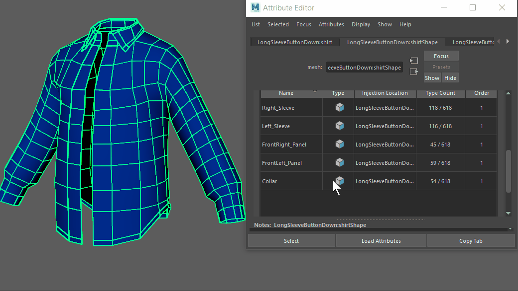

Select a Component Tag
  1. Select the geometry in the Outliner or Viewport.
  2. In the Attribute Editor, click the shape node of the geometry and expand the Component Tags section.
  3. Right-click a Component Tag in the table, and choose Select Components from the menu. If nothing is listed in the table, make sure the geometry is selected.

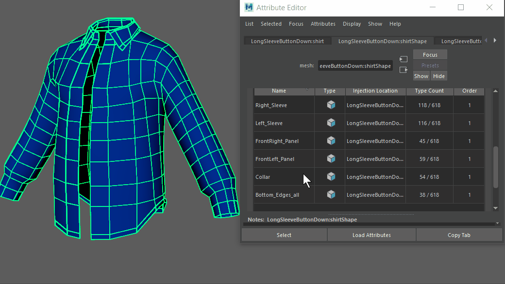

To add elements to an existing Component Tag
  1. In the Component Tag section in the Attribute Editor, select the Tag that you want to add more components to.
  2. Go to the geometry, press Shift, and select the components you want to add.
  3. In the Component Tag table, right-click the tag to which you are adding components and select Add Selected.
To remove elements from an existing Component Tag
  1. In the Component Tag section in the Attribute Editor, select the Tag that you want to subtract components from.
  2. Go to the geometry, press Ctrl, and select the components you want to subtract from the grouping.
  3. In the Component Tag table, right-click the tag to which you are adding components and select Remove Selected.
