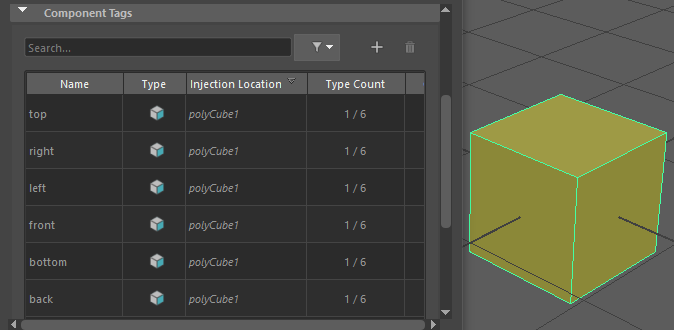

In the Attribute Editor, click the geometry shape node and expand the Component Tags section to view the Component Tag table.
Right-click the corresponding row in the table and select Delete or Rename. To edit the membership of a Component Tag, see the steps for Add/Remove, below.
Note: Component Tags are included with some primitives by default. If you don't want them applied, go into the primitive Tab (for example, Cube1) in the Attribute Editor and turn off the Component Tag Create option.
The default Component Tags of polyCube1.
