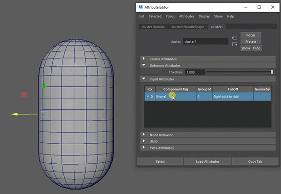

Component Tag expressions
You can use expressions to search the Component Tags table or the Deformer Attributes Widget.
