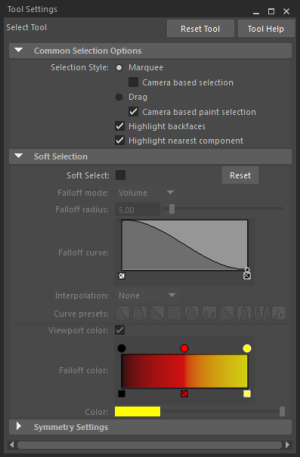

The Tool Settings panel displays many working options for the currently selected tool. For example, you can set many options for the Select (shown below), Move, Rotate, and Scale tools in this panel.
To open the Tool Settings panel, do one of the following:
  • Click the Tool Settings icon in the sidebar icons on the right side of the Status line.
  • Double-click any tool icon in the Tool Box, such as the Select or Move tool.
  • Choose Windows > General Editors > Tool Settings.
Opening the Tool Settings panel from the Tool Box and the sidebar icons
