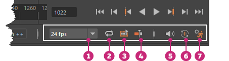

The Playback options, located next to the Range Slider, let you change settings regarding animation playback, such as frame rate, looping, and Auto keying.
1. Framerate menu 2. Loop 3. Cached Playback 4. Context View 5. Volume 6. Auto Key 7. Animation Preferences
