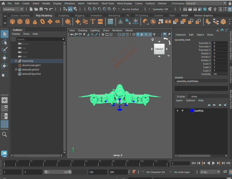

The Workspace drop-down menu is at the upper right of the Maya interface
You modify the current workspace by opening, closing, and moving windows, panels, and other UI elements, as well as by docking and undocking windows and panes.

To switch workspaces
- Select an item from the
Workspace selector at the far right of the main menu bar.
- Select an item from the menu.
