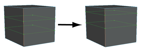

- Slide
- Specifies where the edge is inserted on the mesh. When
Slide is set to 0.50 (default), edges are inserted in the middle of a face.

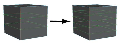

- Segments
- Specifies the number of connected segments that are inserted into the mesh. The default is 1.

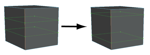

- Pinch
- Specifies the distance between the outer edge(s) and the connected segment(s).
