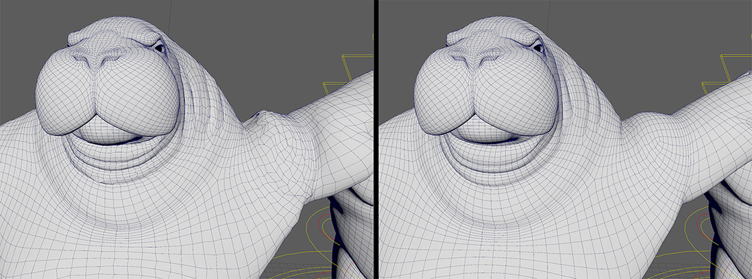

Learn Surface
Activate to train the deformer with additional vertex frames, rather than having the model guess the deltas and the surface. This can improve noisy results. To use it, make sure that Delta Mode is set to Surface and Export Surface Information is enabled in the Export Training Data settings.
Learn Surface: Off vs Learn Surface: On
