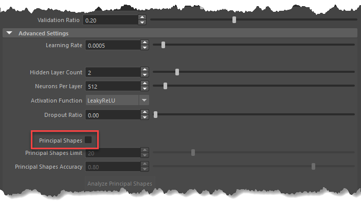

  3. Expand the Advanced Settings section and check Principal Shapes.
    Activate Principal Shapes

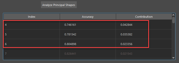

  4. Click Analyze Principal Shapes.
    It may take time to analyze depending on the size of the training data. Once the analysis is complete, the table is populated.
  5. Review the table populated by the analysis. Rows in white indicate the Principal Shapes that will be used in training. There will be as many shapes as set in the Principal Shapes Accuracy setting, but no more than the Principal Shapes Limit.
    White rows indicate Principal Shapes used for training
  6. Adjust the Principal Shapes Limit and Principal Shapes Accuracy sliders to include the number of shapes you want to use. The number of shapes to use depends on the rig and deformations being approximated, and sometimes, it may not be possible to reach the level of accuracy required.
