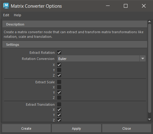

To open the Matrix Converter options
- Click the Matrix Converter Connection drop down button in the ML Deformer Control Collector attributes window
The Matrix Converter options let you create a Matrix Converter, choose which transforms to extract, and select a format to represent rotations with.
- Extract Rotation
- The Extract Rotation rotation settings have the additional option to select the rotation conversion:
- Rotation Conversion
- Rotation needs to be converted for Matrix conversion. Choose from
- Euler (default)
- Quaternion
- Double Axis
- Triple Axis
- X, Y, Z
- Choose one or more rotation axes to convert.
- Extract Scale
- X, Y, Z
- Choose one or more scale axes to convert.
- Extract Translation
- X, Y, Z
- Choose one or more translation axes to convert.
