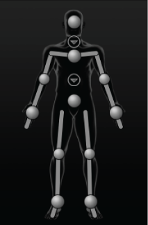

The following image shows the default layout in the Custom Rig tab. The configuration file has not yet been edited.

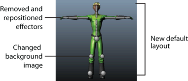

The following image shows the Custom Rig layout for the same character after some simple modifications to the CustomRigControlsConfig.xml file.
