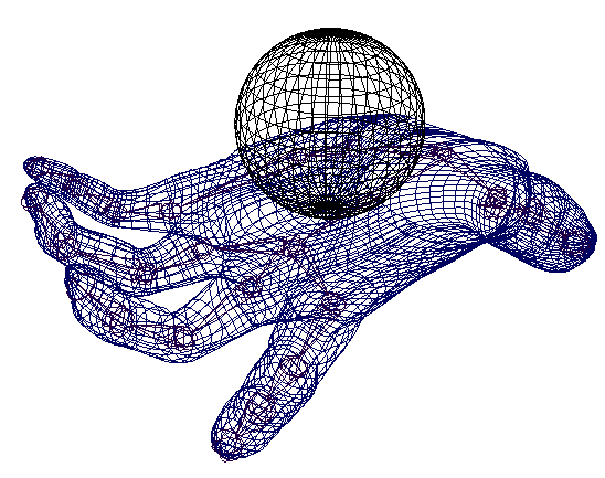

A geometry constraint restricts an object to a NURBS surface, NURBS curve, or polygonal surface (mesh). If you also want the constrained object to orient itself to the surface of the target object(s), use a normal constraint. For more information on normal constraints, see Normal constraints.

The target point is the position of the target object’s nearest surface location. If there is more than one target object, the target point is the average position of the nearest surface locations of all the target objects. If you are using more than one target object, you can vary the influence of each target object on the calculation of the target point. The target point can be a weighted average of the nearest surface locations of the target objects, with some target objects having more influence than others. The influence of target objects on the weighted average is specified by target object weights.
