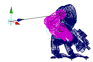

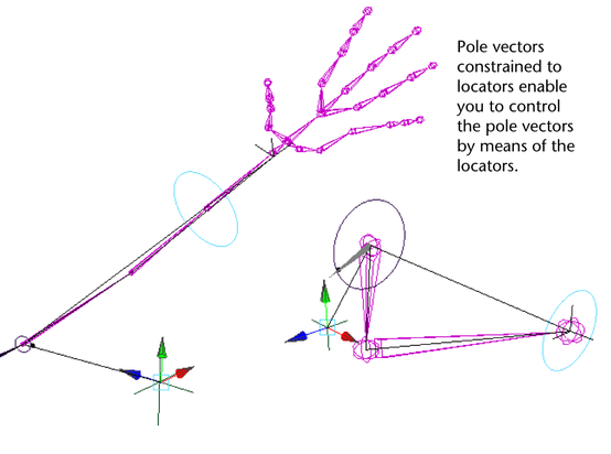

In character setup, the pole vectors of IK rotate plane handles for arm joint chains are often constrained to locators placed behind the character.
In general, you want to constrain a pole vector so that the joint chain does not unexpectedly flip when you manipulate the IK rotate plane handle. Because flipping can occur when the handle vector approaches or intersects the pole vector, constrain the pole vector so that the handle vector is unlikely to cross it.
