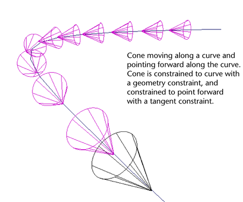

Tangent constraints constrain an object’s orientation so that as an object moves along a curve, the object always points in the direction a curve. The curve provides the path of the object’s motion, and the object orients itself to point along the curve. Tangent constraints are useful for having an object follow a curve’s direction, such as a roller coaster car following the tracks.
See Create tangent constraints and Tangent constraint options.
