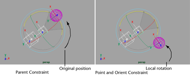

An object with a parent constraint does not behave the same as an object with a point and orient constraint. When a Parent constraint is used, rotating the target object(s) affects the constrained object’s rotation along the world axis. When a Point and Orient constraint are used, rotating the target object(s) affects the constrained object’s rotation along its local axis. This is shown in the following figure.
