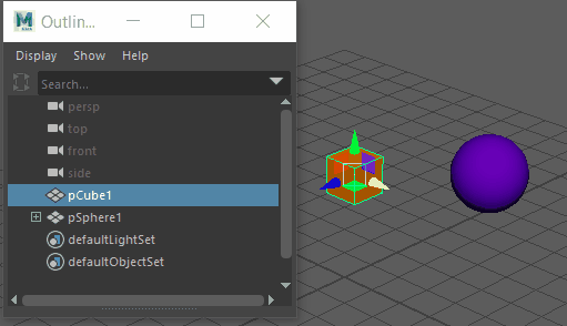

To delete a constraint in the Outliner
  1. Open the Outliner.
  2. Expand the constrained object and select the constraint.
  3. Press Delete.
To delete a constraint in the Node Editor
  1. Open the Node Editor.
  2. Select the constraint node.
    You can select the constraint selection handle, if one displays, or use the Hypergraph or other node editor to select the constraint node.
  3. Press Backspace, Delete, or select Edit > Delete.
