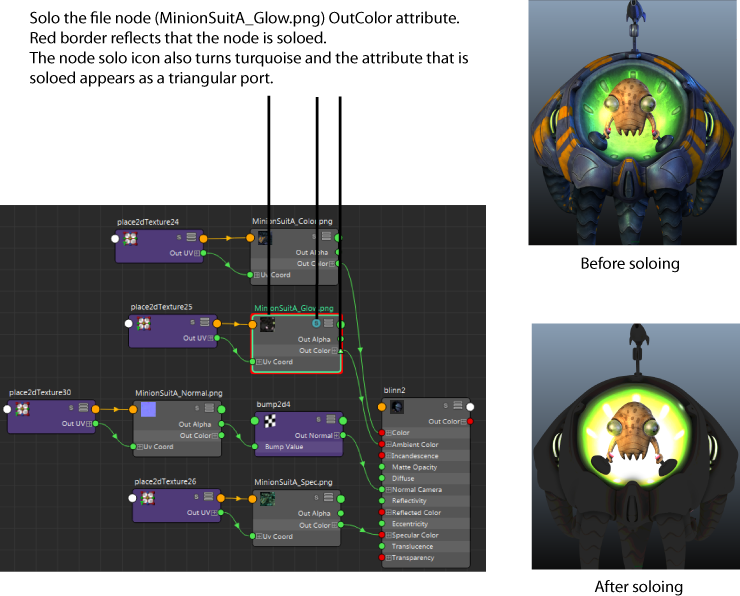

You can recognize a soloed node by its red border, by the soloing icon on the node which changes to turquoise, as well as by the soloed output port which becomes triangular.
Determining if a node can be soloed
When the node is soloed, its soloing icon turns turquoise
, and the border of the node turns red.

Soloing an attribute
A soloed attribute appears as a triangular port
When you solo a node using the soloMaterial MEL command, you can also specify the attribute that you want to solo.
Otherwise, if you solo a node without specifying an attribute, such as by clicking on the soloing icon, Maya checks to see if you have previously soloed a specific attribute on this node. If so, that same attribute is soloed again. Otherwise, the default attribute is soloed. You can then solo a different attribute by double-clicking its port.
The NEDefaultSoloOutput view definition in the NE<NodeType>Template.xml file indicates that a node can be soloed, and the attribute that is to be soloed by default. In the example above, <property name='outColor'/> is included in the view definition, and therefore outColor is soloed by default.
