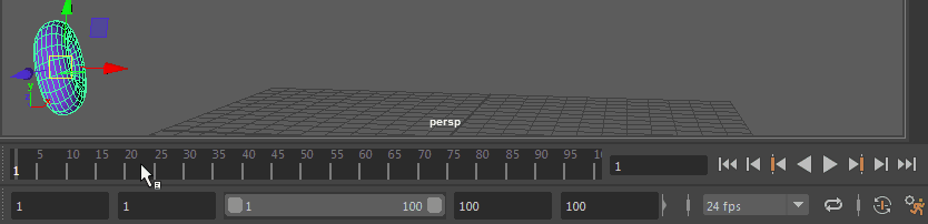

Use Auto Key
Auto Key, found beneath the Playback Controls, automatically sets keys on attributes every time you change the current time and attribute value. A key must already exist for an attribute before you use Auto Key.

To Auto Key an animation
  1. Turn on Auto Key in the Playback Options. When Auto Key is active, the button is highlighted red.
  2. Set a key on any attribute of an object.
  3. Go to a new time in the Time Slider.
  4. Change the value of the previously keyed attribute.
    A key is created for the attribute. You can create another key by going to a new time and changing the value of the attribute again.
