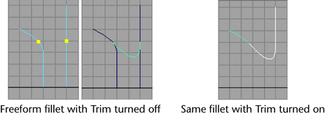

- Trim
Keeps only the parts of the original curves that flow toward the fillet curve ends. Other parts are deleted.

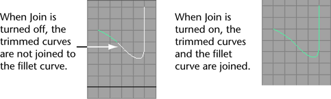

- Join
Joins the trimmed curves to the fillet curve, thereby creating a single curve. Available only when Trim is on.
