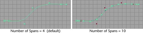

Uniform rebuilds a curve with uniform parameterization. With this option, you can change the Number of Spans and Degree of the curve.

- Number of Spans
Specifies the number of spans in the resulting curve.
