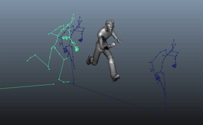

You can display clip ghosts that represent the clip animation in 3D space, letting you preview the trajectory of the clip and helping you manually match poses from clip to clip.

  2. Right-click a clip and select Show Clip Ghost.
    The Show Clip Ghost option changes to Hide Clip Ghost if the ghost is already displayed.

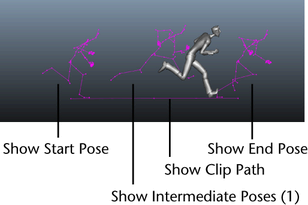

By default, clip ghosts display in the scene as 3D wireframes that represents the first and last poses in the clip, with a line drawn between them to indicate the trajectory of the animation. You can change the display of clip ghosts, for example to add more poses between the first and last frame.

    • To turn off the display of the first and last pose ghosts, turn off Show Start Pose and Show End Pose.
    • To display additional clip poses (besides the default first and last frames), turn on Show Intermediate Poses. Set the number of poses to display in the Intermediate Poses field.
    • To turn off the line that displays between poses to indicate the clip trajectory, turn off Show Clip Path.
