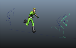

When manipulating the clips in an animation sequence using the Trax Editor, you can use clip matching options to automatically align clips based on a specified object, or display interactive clip ghosts that let you manually align the clips in the scene.

  4. Do either of the following to align the clips in 3D space:
    To manually align the clips:
    • Select a clip ghost, then move and rotate it until it aligns with the trajectory of the next clip.
      Tip: With a clip ghost selected, press D + drag to adjust the position of the clip ghost pivot. Enable Snap to points in the main Status line (toolbar) to snap the ghost pivot to a specific point, such as a bone on your character's skeleton.
