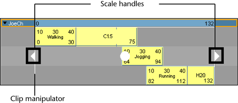

- You can select multiple clips (Shift-click) in one or more characters and scale them all at once using the scale handles of the clip manipulator.
