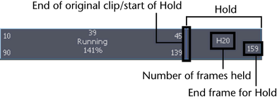

- Shift-drag the upper corner clip hotspots to create holds after clips.
The Hold mouse pointer
appears when you are creating a hold for a clip.
A hold is a part or an extension of a clip where the last pose is held for a specified period of time. Holds are represented by the letter H and appear a lighter blue than the rest of the clip.

Channel Box, set the
Hold channel value to create a hold after the clip.
