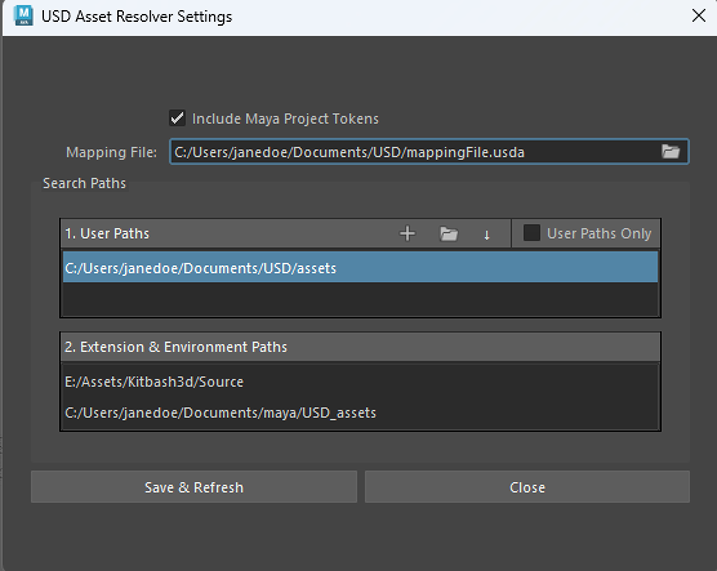

Asset Resolver. The newly added Asset Resolver automates path resolution and streamlines asset loading using search paths and tokens. This reduces errors and broken paths, letting you focus on creative work instead of troubleshooting file paths. This feature is available on Windows and Linux.
