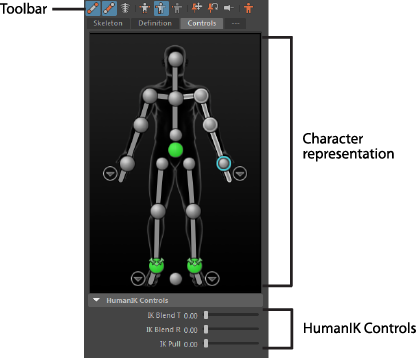

Controls tab toolbar
  • The Controls tab toolbar is found above the HumanIK window Controls tab

Manipulation and keying modes
These icons let you set manipulation and keyframing modes for working with the character’s Control rig. You can manipulate and set keyframes on the character’s entire body (Full Body), a part of the body (Body Part), or only on the selected effector ( Selection ).

The Character representation displays white highlighting on cells to show which part of the character is active for manipulation and keying. For example, in Body Part manipulation mode, when you select a left wrist effector, all left arm cells in the Character representation highlight in white. See Controls Character representation for more information on cell feedback.

Pinning feedback displays on each cell in the Character representation.
