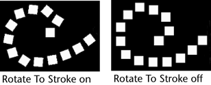

Rotate To Stroke
Determines the alignment of brush shapes that are not uniformly round. Turn this option on to align the stamp shape relative to the direction you move the brush. Turn this option off to align the stamp shape relative to the up vector. The stamp shape retains its orientation when you change the view.

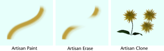

Artisan
Select one of the following Artisan brush operations. Maya uses the last Artisan brush profile selected for that operation. However, if the last profile was a custom profile, Maya remembers only that it was a custom brush, not which custom brush. This means that changing the custom brush for one operation changes it for any other operation with the custom brush profile selected.
Paint
Applies paint to the surface according to the defined settings.
Erase
Removes the color from the painted pixels, revealing the last saved texture. To set the background texture to erase to, turn off Update on Stroke and click the Save Textures button. Flooding with the operation set to Erase restores the texture to its last saved version. See Erase, smear, and blur paint.
Clone
Clones a sample of the paint already applied to the surface. You can then paint that sample elsewhere on the surface or on other surfaces. You cannot flood with the operation set to Clone. See Clone paint.

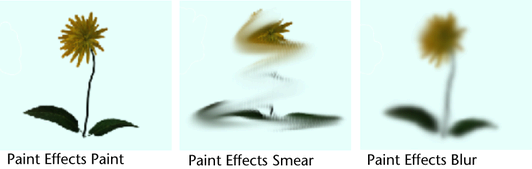

Paint Effects
Select one of the following Paint Effects brush operations. When you select a Paint Effects brush from the Content Browser or your shelves, the 3D Paint Tool automatically sets the operation to correspond with the Brush Type setting of the brush. (Brushes with an Erase brush type are not supported by the 3D Paint Tool.)
The 3D Paint Tool uses the last Paint Effects brush selected for that operation. If no Paint brush was previously selected, the default Paint Effects paint brush for that operation is used.
Paint
Applies paint to the surface according to the defined settings for the selected Paint Effects brush. Maya uses the Flood Color when you flood with Paint EffectsPaint selected.
Smear
Blends adjacent colors together along the stroke path. You cannot flood with the operation set to Smear.
Blur
Blurring with a Paint Effects brush softens the edges of adjacent colors by averaging their color values. You control the blur using the Blur Intensity slider. You cannot flood with the operation set to Blur.
All brush types use the shape defined by the brush attributes. For example, if you paint over a stroke with a Blur brush that has tubes, blurring occurs where the tubes cross over the paint, not along the Blur stroke path.

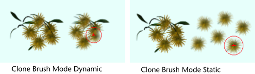

Clone Brush Mode
Select Dynamic to move the clone source (the area the paint is sampled from) as you move the destination brush.
Select Static to keep the clone source stationary.
Set Clone Source
Click this button and then click an area on the surface to set that area as the source, or area where the paint sample is cloned from. If you paint over the clone source during a stroke, the original paint sample is used for the rest of the stroke, but the next stroke uses the updated clone source paint sample.

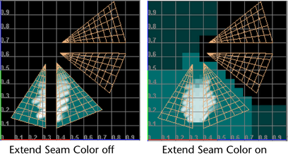

Extend Seam Color
This option ensures a smooth transition between texture attributes at UV shell borders when you render. When this option is on, Maya extends the color you paint into the background past the shell and averages the painted and background colors at the border. This option is off by default.
