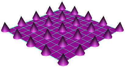

Select the desired U and V Grid Size. Artisan paints the geometry on the grid point of the U and V grid you specify here, regardless of the isoparm density you set for the surface. The larger the grid size, the denser the geometry.
In the following example, the isoparm density of the surface is 10, but the U and V Grid Size are both set to 5 in the Geometry Paint Settings window.

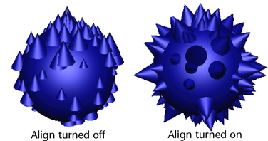

Align
Aligns objects along the surface normal.
